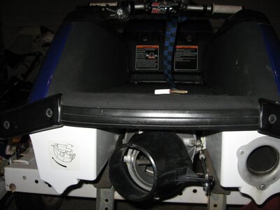

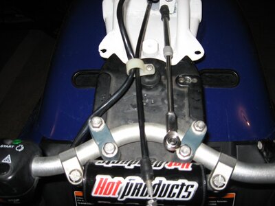

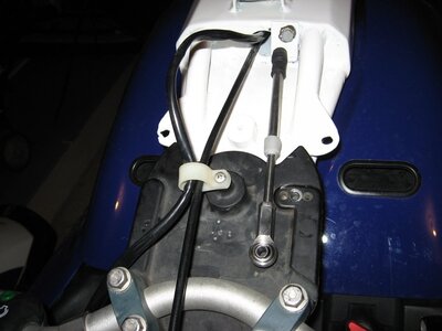

Whats up guys I am in need of some help. Me and a buddy installed a ac racing pole and a blowsion heavy duty cable on my 09 SJ. We installed the cable just as the old one was, The long end on bottom and the short end on top. But now when its installed, with the bars straight the nozzle is completely to the left. And when I disconnect the top and make the nozzle straight, it pushes the top like 2 inches past where the mountin location on the turn plate is. I am using the stock turn plate until I can get a new system. But I wouldn't imagine that with a new turn plate that it will relocate where you attach the cable back 2 inches. Totally lost, Did we install backwards? Theres no way to adjust it so it works. Do I just need a new steering system?
The second pic is of where the cable should be with the nozzle straight.
The Third is where it would be with the nozzle all the way right...And that seems insane..
