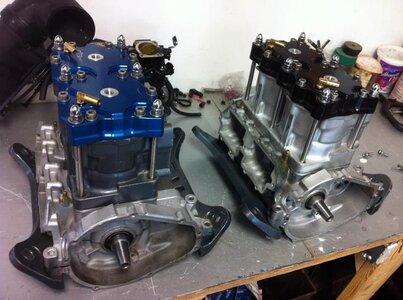

Im ripping a BB850 62T/62T at 170 psi built in house here in Quebec, and it rip awesome. It hit close to my 5mil stroker ADA910cc Art built me last winter. Very impressive for the price. If you plan to go BB771 think about BB850. CR500 piston are offer in multiple bore compare to 85-86mm piston. Only my 2 cens !

Yes we use 62T cylinder. 62T cylinder its the only oem cylinder who can received the BB850 sleeve because the cast of the cylinder is bigger than the 61X. We use Cr500 piston series with ADA superbore girlded head kit. We built it with SBT superjet crankshaft. We use Blowsion BB Sleeve. The case need to be bore and epoxy job as well.
