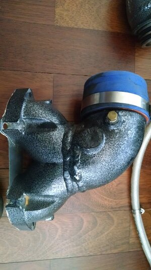

Need some help with this speedwerx exhaust.
Someone definitely screwed up that manifold. Here's mine, 90 should be flat to the exhaust port inlets.

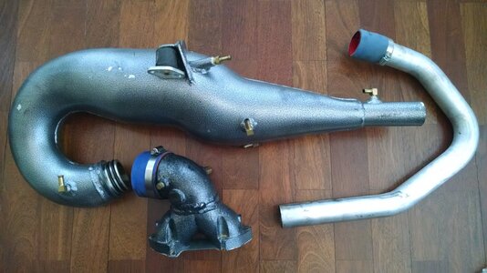

Also this pipe needs a piece like I show in the below pic to route around the nose. A silencer is then used on the straight tubing section you'll need to get to the hull exit.
