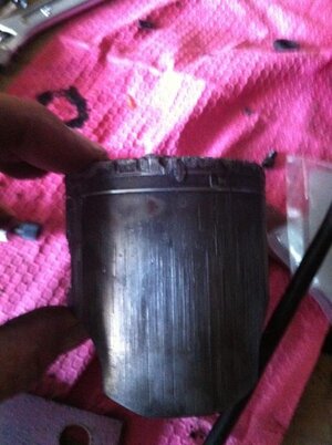

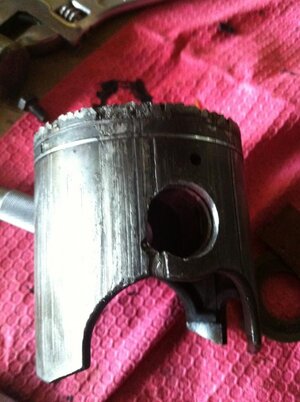

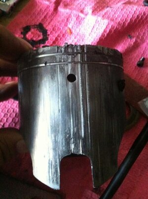

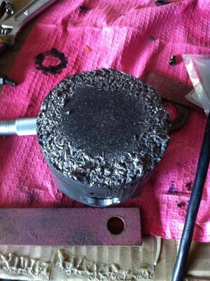

Any thoughts on what the cause of failure could have been,from the pics of the rear piston I provided..Front piston is o.k. back totally fu**ed..
If it was a lean issue,I need to correct it so as to not kill mew motor..

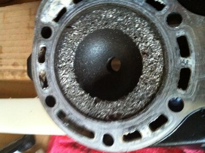

Also can this head be saved or just look for a used one...

I,m thinking a piston that looks like this is severe over heating or lean..I can't see one piston over heating due tp a cooling issue like this and the other is fine so that leaves a lean condition..
If this is the case what would go wrong or change in the carb to make it run that lean.....

Running lean doesn't always happen from issues in a carb. The issue could have been from bad fuel, leaky crank seals(allowing more air into motor, leaning out air/fuel ratio), leaky intake gaskets. Issue could have always been present, but recently have gotten worse. Or, your diaphragm could be wearing out and not pumping enough fuel...or carb could have gunk in jets.

Anyone have a stock head for sale,are all 800 heads the same or do I need one off an xl 800
Heads are the same. Any 800/66e head will work.

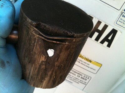

this one is same situation - boss's ski. I'm not sure if he was riding it, or his son was when it died. he had taken it to a "mechanic" about a week before to have the carbs reworked. I haven't gotten into them, but I think I better. It was after the carbs were rebuilt that the rear cylinder snagged a ring.
luckily no apparent damage to cases, crank or head

this could have happened from running 87 octane. usually a lean burn down will melt the piston on the exhaust port side until it hits the rings and you loose most compression in that cylinder. go over the carbs and everything else, ditch the oil pump IMO.
