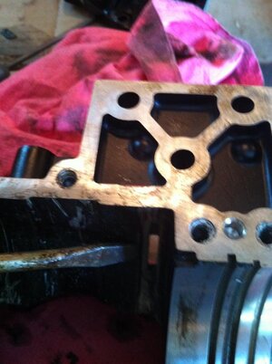

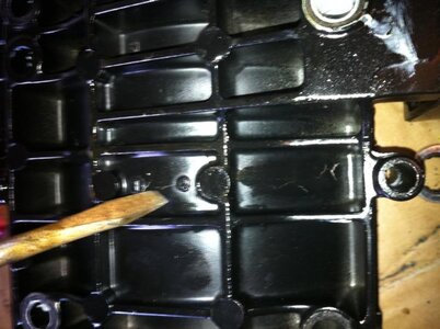

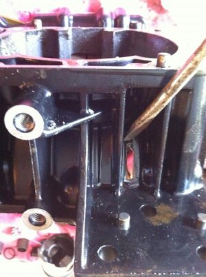

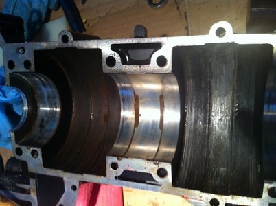

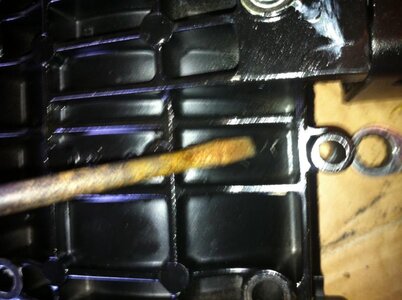

split the cases and found a lot of debris in the bottom end ,not sure from what ,thrust washers are ok..center bearing may have lost a bearing cage...I will have to cut bearing off or press apart to find out for sure yet..
The lower case has a hole right through 1/8 x 1" and the upper appears to be cracked..hard to see though, it looks like a hair line, is there a way to tell for sure,can I buy something to test for cracks..
the first pic shows the slotted hole to the left of the bearing surface
Can I epoxy it with jb weld ..On the back side there is a whole pocket between webs that I could fill up...
I would be afraid to tig that it would cause to much heat...

And the plot thickens..
The lower case has a hole right through and the upper appears to be cracked..

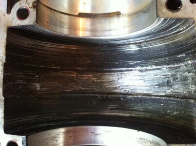

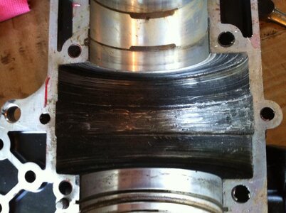

So do we think I can epoxy these cases

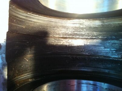

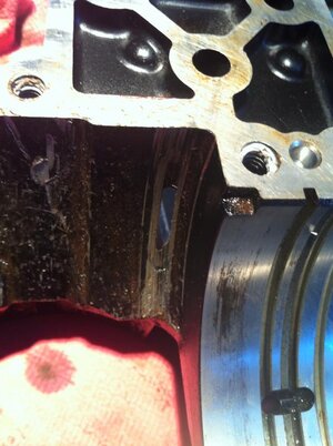

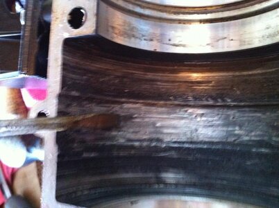

Here are some better pics of the cases,you can see the hole in the top case in pic 5 and the view from the back in pic 6
the bottom case is deffinately cracked in at least two place as seen by the tip of the screwdriver pics 1-5

i have had welded cases before. you surely have someone there to weld them? JB weld may work, i mean we epoxie the intake cases on our 62t and they hold in there. welding cast is very tricky and may need to be done with some cool downs inbetween welds. if you overheat it, it will crack when it cools.
