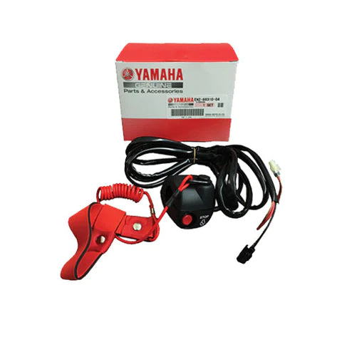

Just an FYI because I recently learned this - you can buy the button internals separately if they are acting up but you already have the switch housing. This part is only listed on the 90-95 parts fiche, but the switch housing is the same for 1990-2020 so should fit any of those no problem.
The Dude is correct - that is the only way to go, you get everything you need other than the plastic clamshells, which hardly ever break. Swapping the new harness into your existing plastic halves is easy. My 2 cents anyway..
