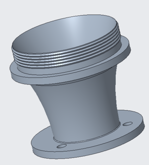

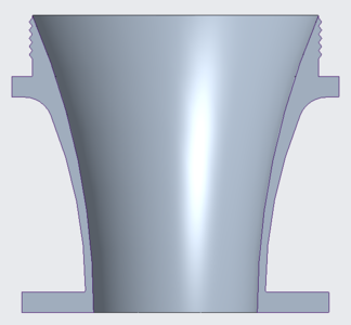

@Quinc to your point, I've also been looking at a velocity stack with a gradual taper to it. Perhaps this would be of more interest to people?
To @waxhead point - the ADA's have such a quick transition, I'd imagine a more gradual curve would have to yield improved airflow and performance. I plan to get some flowbench data and compare. I'll share those results with everyone once it's available.
I think this is a much more promising direction.
If you have an accurate flow bench and access to a 3D printer, it would be interesting to see a few of your designs tested vs the ubiquitous ADA design.
It would also be interesting to see each design tested with various flame arrestors to see how restrictive they are.
Sometimes I see $1200 carburetors with low profile flame arrestors and wonder if those people are really geting anything a 46mm sbn couldn't do. I don't know, but I wonder.
Similar story with hulls that have only pole breathers.

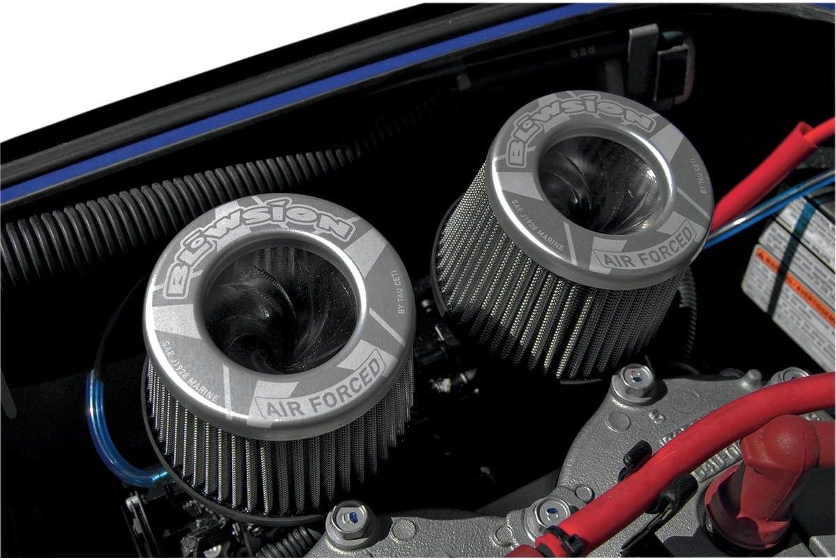

Please test with and without https://www.blowsion.com/blowsion-outerwears while you are at it. Some people swear by them, others say they are worthless and restrict air flow too much. I am assuming they restrict, especially once wet, but if its not too bad it would be worth it to keep water out of the engine IMO.
My experience with out wears is they work best when they are in the bin. I see no reason to put on high flowing carbs and intake then to restrict it down. Every times you put on outer wears your ski will go rich and you will lose rpm and need to jet down . This is a clear indication that you are running rich.

My experience with out wears is they work best when they are in the bin. I see no reason to put on high flowing carbs and intake then to restrict it down. Every times you put on outer wears your ski will go rich. This is a clear indication that you are running rich.
That was always my thought, though i never did any testing. Sure would love to keep water out of my carbs though lol
