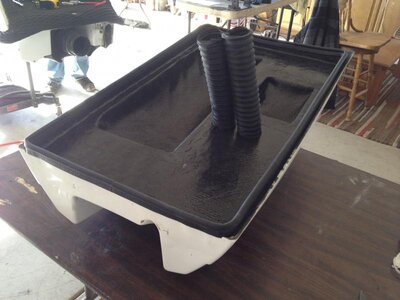

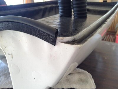

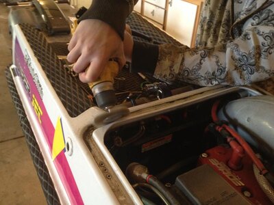

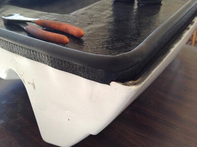

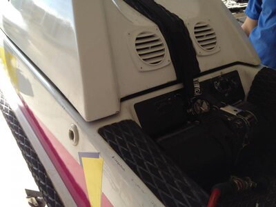

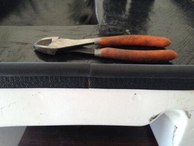

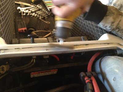

Here's a few pics getting it on the SN hood. The process was easy. Rip out the old seal, clean the area where the old seal was, dremel the front corners of the hood a tad for the gasket, put a little silicone (rtv) on the hood lip and install. Trim the excess with a sharp pair of dykes and you're done. Pics will be in no particular order, not by choice, just the way they load. I'll post back ride results as soon as we get back and warmed up.
