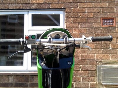

Get a set of straight bars and re-drill your stock turn plate to mount them, you can shorten your steering setup up to 4" I think. Very cheap mod and if you decide to upgrade your handle pole later you'll have a better idea of what lenght you wanna go with...image.jpg

Understandable. Throughout this thread I've steered away from any engine modifications thus far for that reason specifically. Growing up racing MX I understand the concept of a faster engine doesn't make a faster rider. But that never kept me from putting more comfortable bars and better tires on so I don't think ergonomic mods like controls, a grate and a plate are reason to talk smack.
