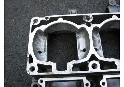

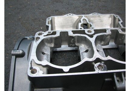

**Just a test fit, so clean :cool2: Need to do the clearencing for the head pipe.

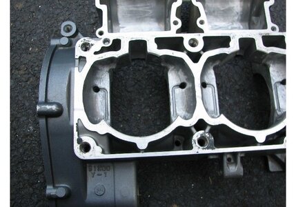

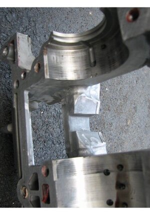

The 61x cases are slightly ported, nothing major. No epoxy filling or anything like that, just cleaned up a little.
