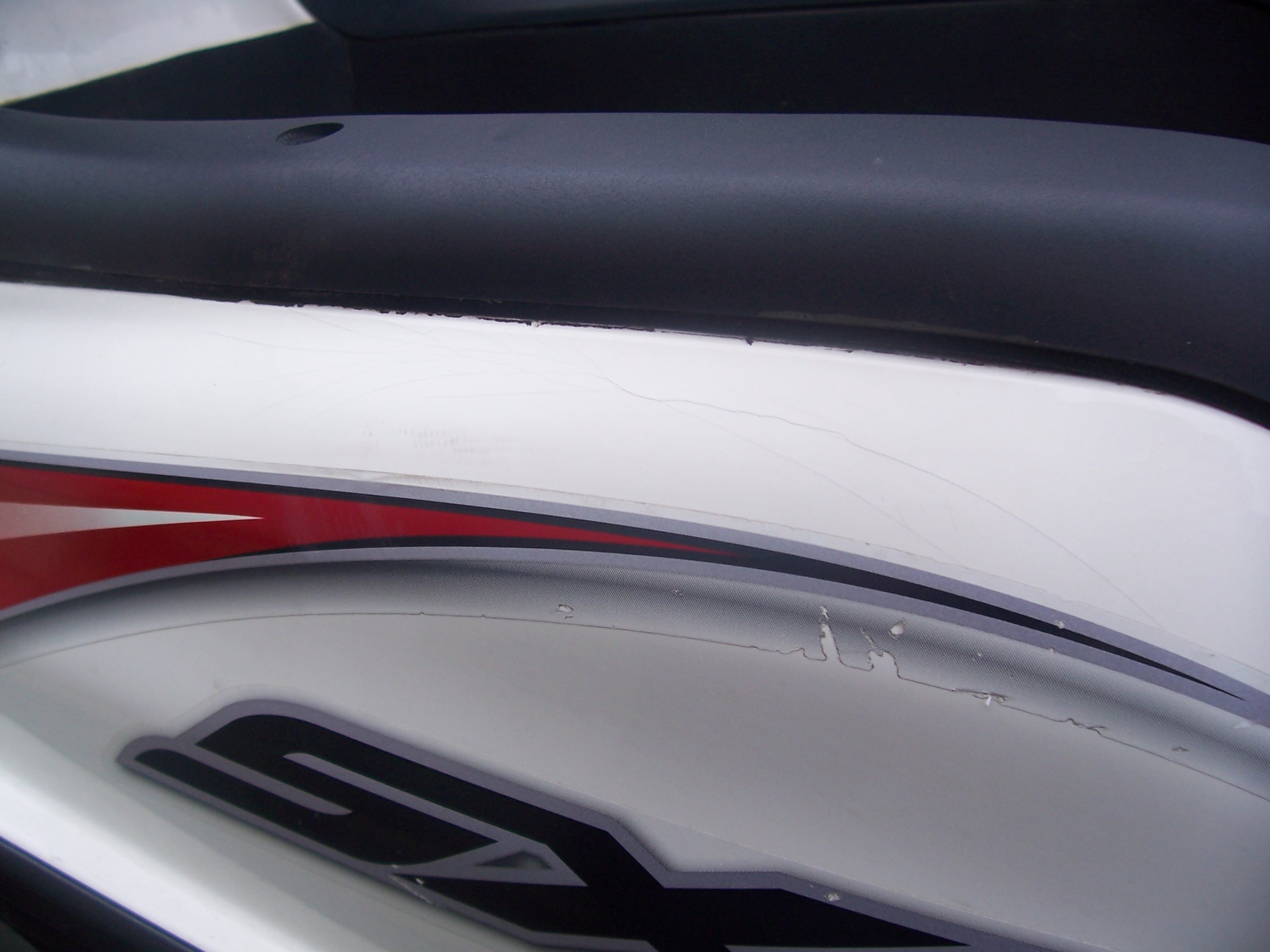

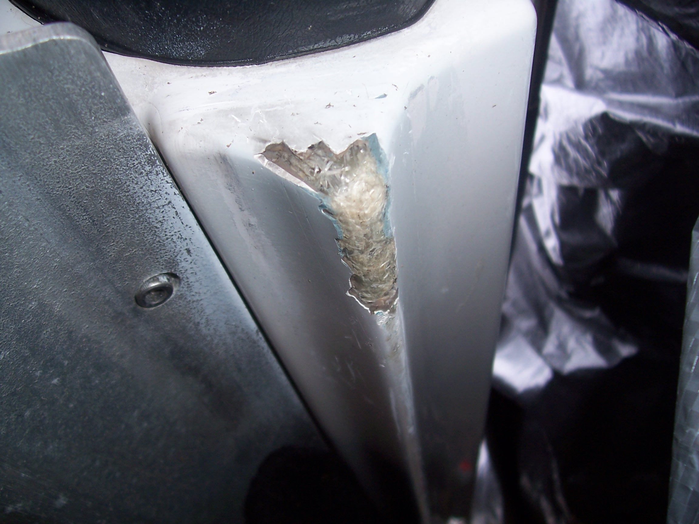

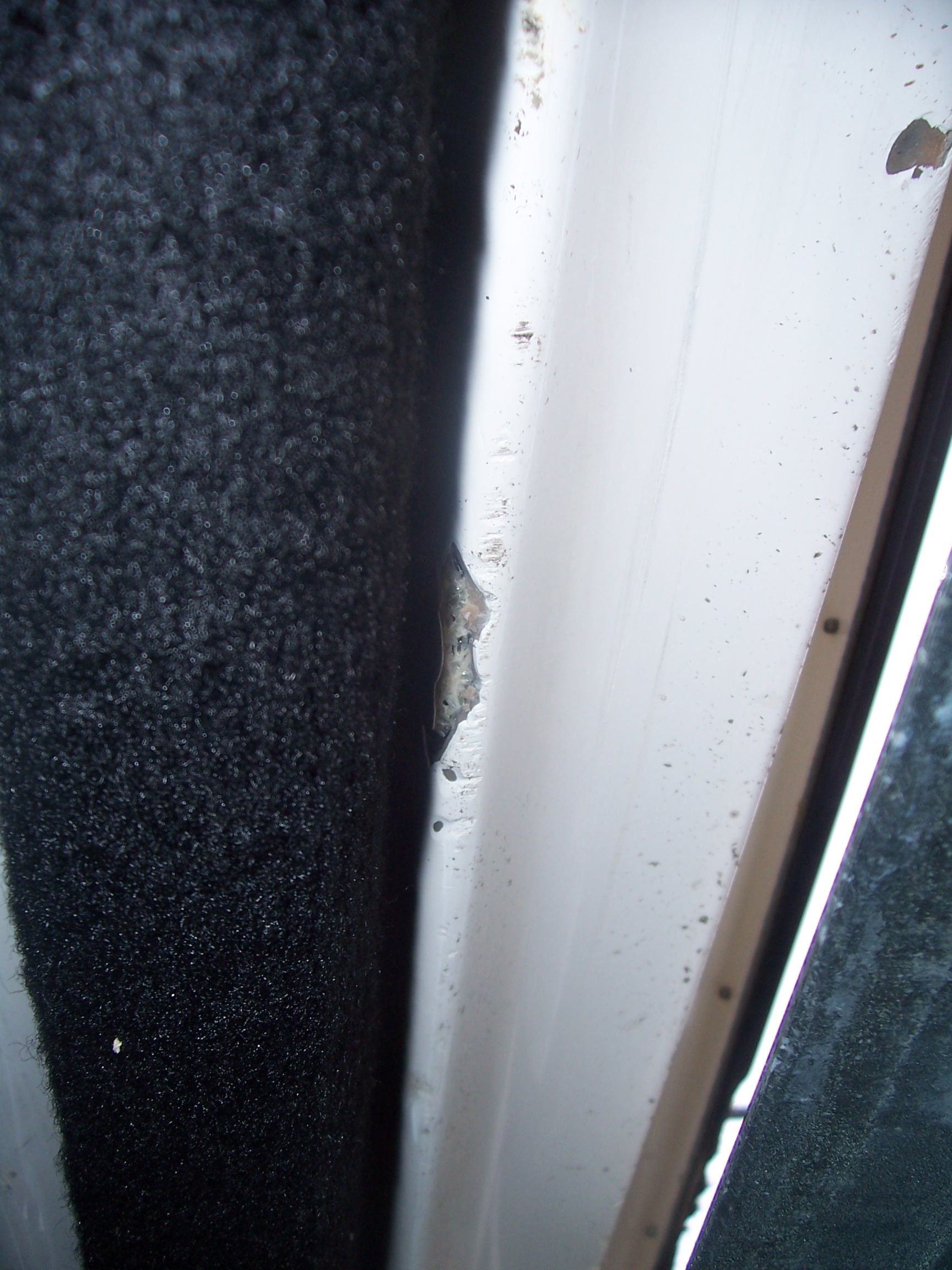

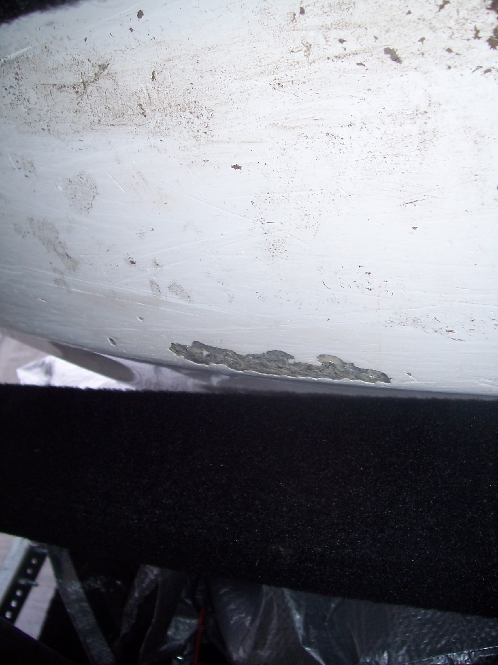

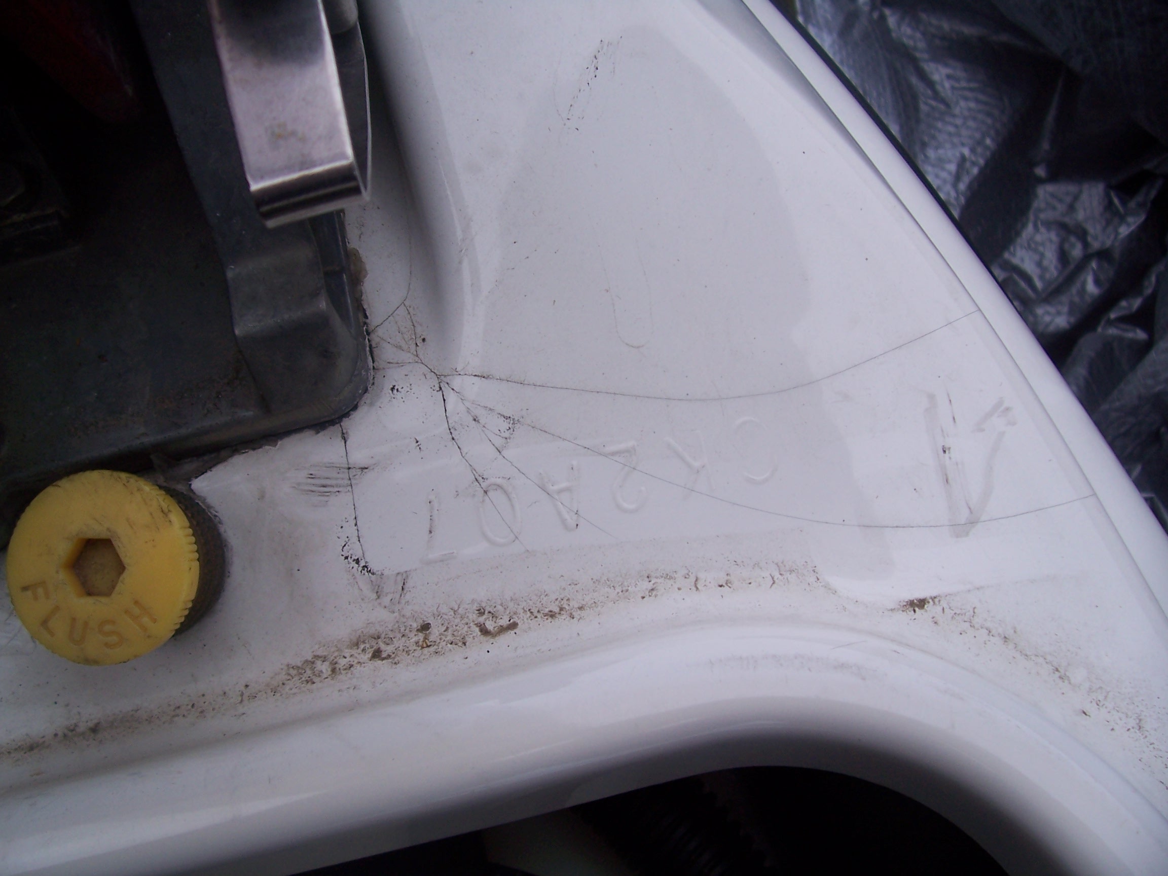

Yup my beloved SXR is hurtin. Shes got stress cracks and chips all across the bottom. I spoke with a buddy of mine for tips on how to fix these i wanted to get your guys second, third, forth, ect lol opinions.
Basically in order to fix cracks. They need to be chamfer'd out (cut a V into them). Fill the V with something like marinetex and on the backsides re-enforce with fiberglass/epoxy. Correct?
As for the chips and scrapeage. Im thinking a mixture of epoxy and either SM Fairing Compound or Aerosil-Cabosil which is better?
Im looking at getting regular 6oz fiberglass and 635 epoxy medium hardner would that be good or is there something better?
