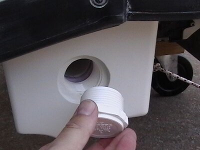

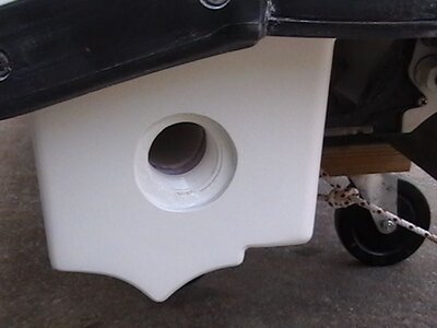

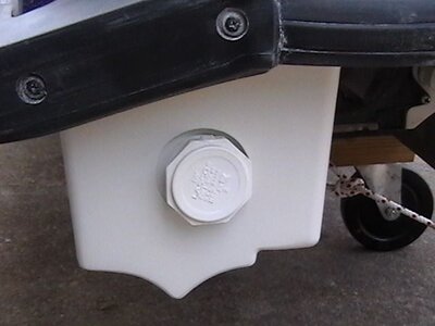

Here's mine. I have some diagrams of how I did it somewhere. Checking now....

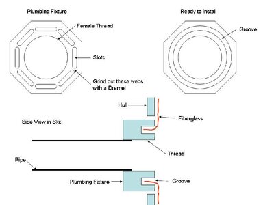

I've got it! Sweet idea SJBrit... Was gonna do it, but after seeing my glassin skills just doin handholds :scared: well here it is...
Sweet! Where did you find that? I've been going nuts looking all over :aargh4:
I remembered making that picture, but I'll be damned if I know where I put it.
h2odesperado
Pin it to win it
Charlotte, NC
I had asked you about it a while ago... you explained it all pretty well to me. Had it saved on my comp in case I attempted it. Props to you for thinking of it and then carrying out the idea so well...
