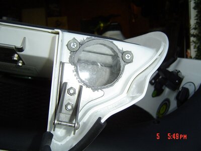

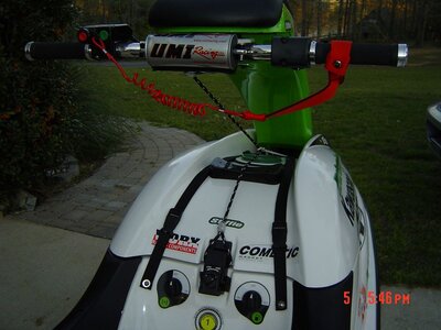

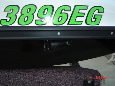

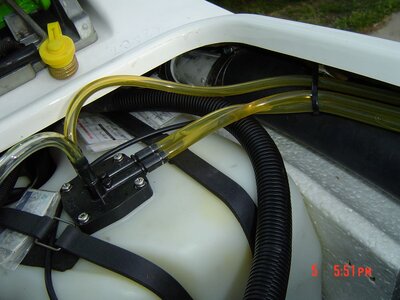

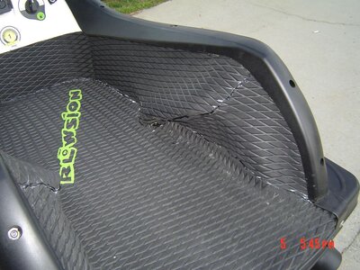

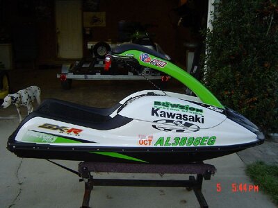

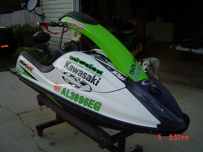

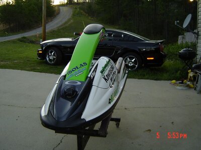

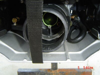

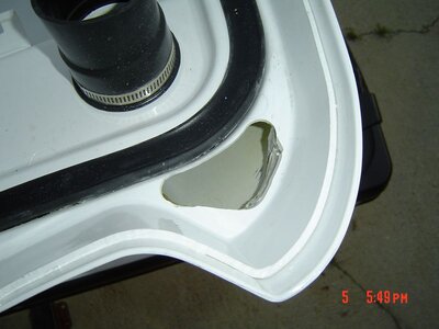

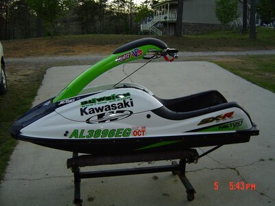

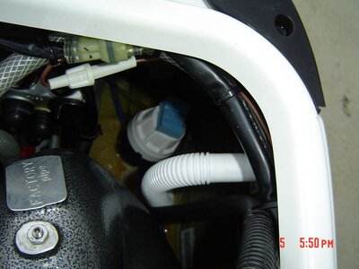

Yall have heard waaay to much B.S. bout my ski-I finally broke down and took some pics. What yall think other than it should be a SJ not an SXR?

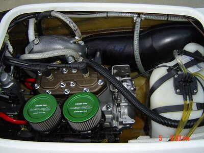

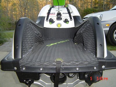

and yet more pics-Im done now. Only things left are things I can't afford yet-ie-carbon fiber hull/hood, porting, TBM flywheel, ignition system.

Mac Mashers
Atwood 500 gph
Blowsion stubby pump cone
stk prop 13/17 set back 5mm
stk plate cut 3.5"
Blowsion pump shoe seal plugs
stk grate
80mm nozzle
wet pipe
Taucettis
80 gram pop off springs
Blowsion pole spring
limiting rope
hood straps
550sx side exhaust outlet plumbed w/pvc pipe
UMI 0deg
ODI ruffians
cut stk flywheel
6deg advance plug
1 REAL EMPTY WALLET-lol

Jarrod-Barbara hasnt told anybody I liked riding her sqaure has she? It's supposed 2 be top secret that I liked a Yamaha!!! BTW-u were soooooo right on the footholds-I am finally used to them and now hate ridin a ski w/o em!!!
Gil that thing is sweet :woot: , I really don't think the SXR has any limitations in the surf, but you're definately pushing poop up hill trying to flat water freestyle with it, find some surf and you'll be set.
I reckon you'd be BR and BF'n in a few days, first day would be one ride then spend the rest of the day putting in real footholds, second day one ride then replacing the pole (last about 2 seconds in the surf), day three backflip and roll all day. :cheer: :Banane01: :cheer:
How does she handle with the plate cut like that?? I've been changing mine a little at a time and haven't got that short yet, mines currently ~1.5" off std length + a ~2" radius cutout. I would like to get the nose up a bit more for wave riding, but I think it might end up a bit loose if I take more off.
Grant
Grant...cut that plate some more...that ski will never be loose!
I do agree the SXR makes a very good surf platform
Nice looking SXR! And as far as cost effective mods...I'm sure Paul could do a little porting work for you that would make the ski feel at leats 50#'s lighter..

As far as the -3.5" off of plate goes, SXR's are squirrly on flat water full of gas-frt end 'seeks a line', that goes away. u know how a 750 is famous for porposing? that comes into play a little, u can shim back of plate w/extra washer on each side and its pretty darn good. Bottom line-I have my stk uncut plate for cheezin around lake w/wife and my -3.5" plate for everything else.
