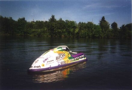

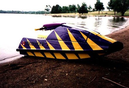

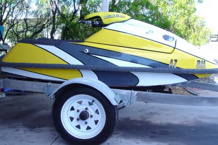

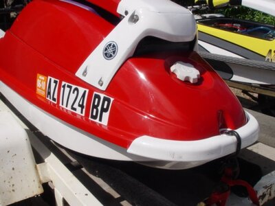

rn superjet.jpg FX1 1.jpg flag bottom superjet.jpg 90superjet_side.jpg Troys750sx.JPG Nason is not bad, have used it before, but like Omni better. Also as mentioned Dupont "Imron" is a good ol paint too. The 1990 purple/yellow SN SJ in the pics below I painted with Imron in 1992 and the hull sits in my backyard now and the paint still looks awesome!
