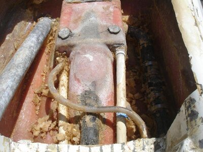

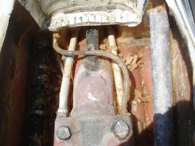

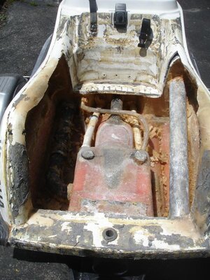

This all started because I broke 3 motor mounts on a failed boat wake roll the other day...
I had no illusions about foam staying dry forever but when I ordered my hull I wanted it ready to ride so I let it go knowing that I would someday have to deal with it. That being said....Jeff did say, "dude that thing is so sealed it will never get wet". But knowing what I knew it pretty much went in one ear and out the other....
1200 plastic beer pong balls and versiplugs on the way...
Pics coming soon but it it just another defoamed hull...nothing special...
Ohio
And the dang footholds weigh like 3+ lbs. each!
And this hull still felt light to ride....just didn't feel light when picking up the back....
