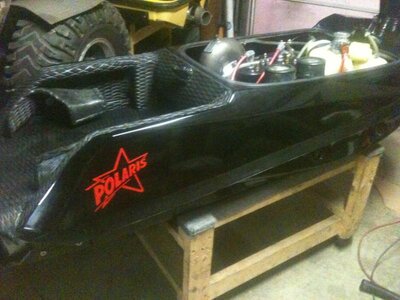

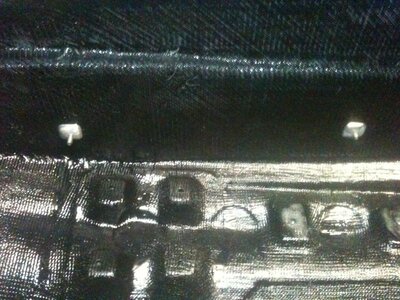

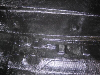

I made and then glassed in inserts so the tubbies could be removed and installed without a wrench on the inside of the hull. I also filled in the big pockets under the engine mount plates so they don't hold water.

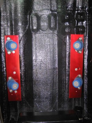

I had to move the right engine plate out and relocate all four engine mounts. RHAAS made the mounts for me, left and right are different heights to make it all work...

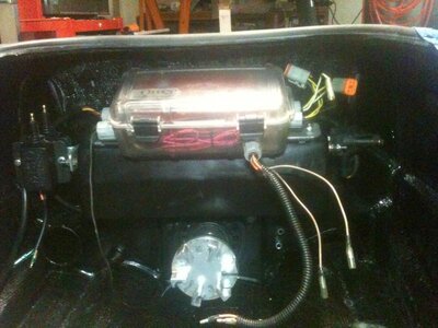

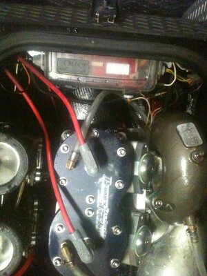

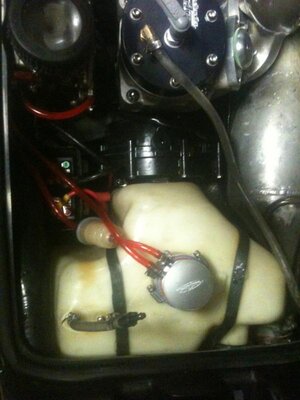

Mounted electric box on top of the foot hold, starter relay on the left side of the hold, coils on a bracket I welded on the right side. I used a yamaha bearing carrier with the Polaris drive shaft.

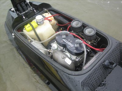

Engine is my 950 Polaris based power valve engine built by Erik running 46 Novis and Total Loss. I had to beat the B-pipe chamber in four different places to fit, I had to cut the Flow Box inlet and exit tubes and reweld them, the heat gun had to persuade the fuel tank. In short, it's a big engine in a small hull. I made the coupler cover and battery boxes out of glass and carbon.

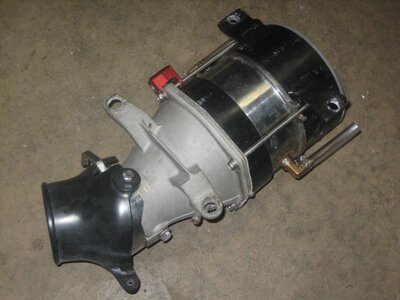

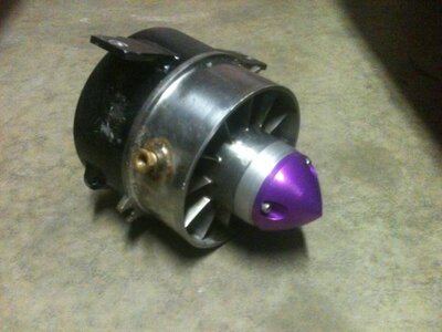

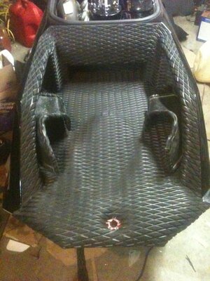

Pump is a Polaris 148 mag that I adapted to fit. I made the foot holds out of glass and carbon so I didn't have to cut the heel straps off the back of the Krash foot holds.

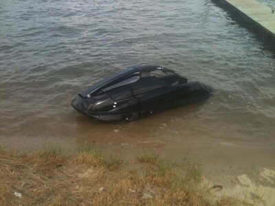

I love the way the hull rides! So nimble yet very stable, and not nose high at all. I came from riding an Octane, so this is a foot shorter and a good bit lighter, but it was so easy to just get on and ride.

The electrical box is like a $20 otter box, $15 in through fittings and the rubber grommets from some Kawasaki and the Octane box. Just the total loss brain and the diode setup for my bilge pumps along with all the wiring fits in it. Relay and coils are outside. They're a lot cheaper and more water water resistant than the brain anyways.
Pump is some obscure 12 vein mag for Polaris. The bearing section was bad, so I took a stock Polaris pump, cut the center section out and turned it down on my lathe. The black pieces are Polaris wear rings that I had machined to all fit together and I welded all the tabs and water fittings on.
