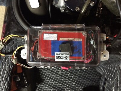

My otter box for the TL finally took more beatings than it could handle and the hinge broke... They don't make those boxes any more, so I got a pelican case and ended up with this for my MSD enclosure... $18 on Amazon.

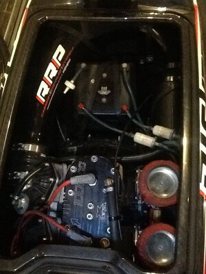

I like to see fellow Polaris builds, I've been running a 1000cc Polaris now for 6 years (it's in it's fourth hull) , I just switched out my pfp for a RRP pipe and I am very pleased . I've also found the 49 full spectrums to be my favorites too

My pfp chamber is hitting the hull and still only close to seating on the manifold properly... Hopefully my tig machine gets fixed soon, then I'll be more comfortable with taking a hammer to the chamber...

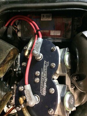

Custom... I think Erik had drawn up Dasa bases in CAD a while ago, and he took that and stretched the bolt holes out to match these cylinders. You could contact him if you'd like some, since he's making me another pair, the more the merrier!...
