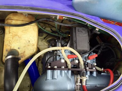

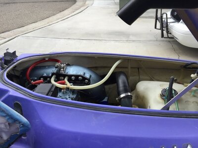

I made a relocation bracket for the ebox today. I mounted it up and it looks like the ebox will be perfectly out of the way of the new pipe. I'm going to paint the bracket and then it's time to finally put my ski back together and take it for a test ride!
Bishop CA
Pipe and cooling hoses are in (minus hose clamps in the pictures)! I'm pretty sure I have the hoses in correctly. I cranked it over for a quick test fire (and I mean short as it still has the factory SBN44 carb with stock jetting) and it sounds pretty mean! I'm going to throw on my new intake manifold and 46mm carb next. So what jetting do you think for 4000' above sea level with my new modifications? Right now the carb has factory Wetjet Kraze jetting (117 low, 155high 1.5 needle). I'm going to change to the needle to 2.3 and set pop off at around 20lbs.
