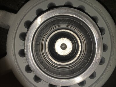

Recently purchased a 148 MAXX mag pump off of here and I'm having trouble aligning it in my hurricane C2. I've seen all of the threads that say to worry about the pump alignment in the channel first by adjusting the back two bolts of the pump with shims to get it centered up and down. That's all fine and dandy but what I'm struggling with is the side to side. It's not even close to being centered from side to side. It's rubbing the left side of the driveshaft channel when I rotate it. Has anyone else had this trouble? Did you have to slot the bolt holes on the pump to allow for more adjustment? Thanks guys!
