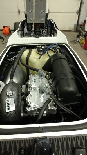

Ok so I just got out of the water, about 45 degree temp

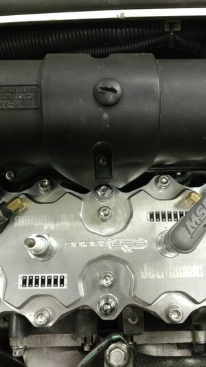

New ada head, dual cooling, I had two 3mm restrictors before both bypass fittings
Rode slowly until up to temp then checked temp stickers on head, head was about 95 degrees. Only had one 2mm restrictor so I put that in the bypass direct from head (other one goes to bottom of pipe)
Cylinder still around 95-105
Well if I put another 2mm in place of the current 3mm I doubt I'll be getting head temp up to 120-130
I've never heard of a 1mm restrictor before but I'm thinking of going for it
Is there anyone against going to a 1mm restrictor in both bypass fittings??
(Head temp was colder than single cooling stock head which makes sense obviously, also chamber never even got to 140 degrees when I think 220 is sizzling point)

May I ask how many temp strips are on your engine and where ?
I'd leave the ball valves alone personally
I agree, I'd rather not restrict the incoming water
And I've got 2 on the head, one on the pipe and one on the chamber in front of the coupler (see pic)
