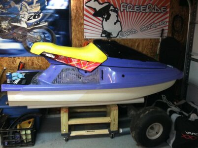

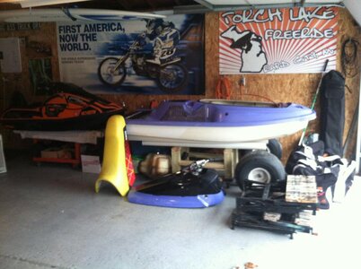

Its winter time here so time to do something in the garage. Not doing anything crazy, no rocker or shorten; just looking to update the 20 year old craft.
Specs:
1993 Yamaha WaveBlaster
61x 701, single carb
Prok F/A
Factory B pipe Mod
Factory pipe waterbox
ADA girdled head (34cc domes)
A/M impeller (not sure of size, previous owner)
Riva Intake
Rive Groovy ride plate
Wet Wolf Cone
oil injection removed
Dual cooling
Paint- Interlux TopSide Easypoxy
Wrap- LG1 Designs
Slippery Runabout bars with 1.5" risers
New seat cover
New turf
New fuel and cooling lines
Flow control valve
P.S. this will be a slow build throughout the winter.
We have picked out the color and graphics, but you will have to wait and see.

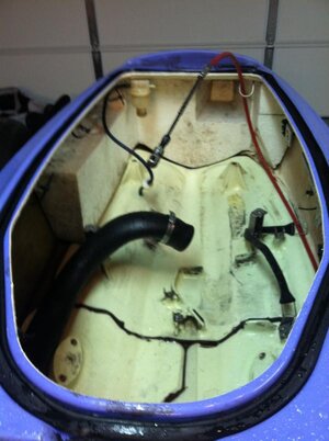

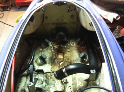

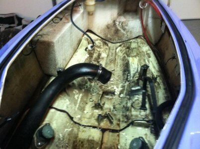

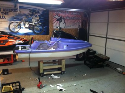

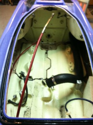

Got it stripped down, and cleaned out. Ready for sanding.
BEFORE:
AFTER:
Probably still do some appliance epoxy white to the engine bay, to make it all one color.

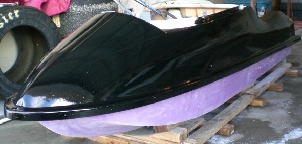

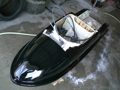

I did the Interlux Topcoat with a roller once, it came out decent but if I had the option I would spray. It wasn't much less work to roll it and the finish didn't completely smooth out, it was a decent 5' paint job.
The black on this Laserjet is Interlux, there are some waterspots on it but you get the idea.

Thanks for posting. I am starting to think I should spray it. I was trying to keep it low cost, but if I am spending nearly $200 on some graphics, probably should put them on a nice painted surface.
yamanube
This Is The Way
Mandalor
I would spray on a cheap, single stage urethane before rolling on interlux, hell you can even spray the interlux if you want.
