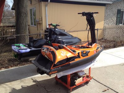

Putting the water box under the seat really frees up the engine compartment. De foaming is a real pain in the @ss but it's well worth it!

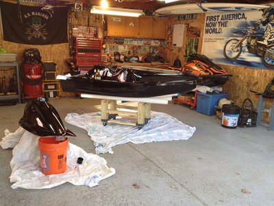

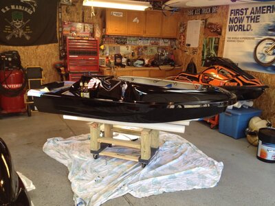

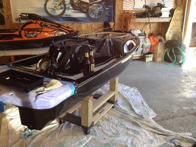

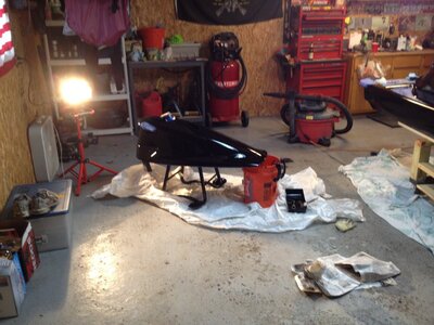

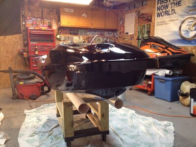

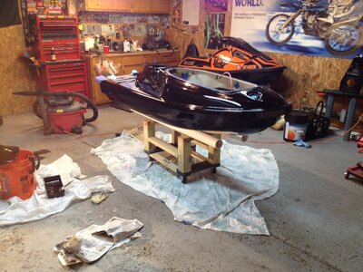

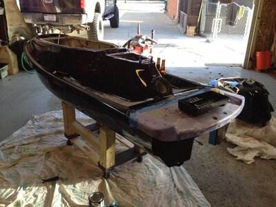

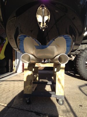

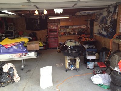

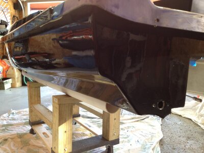

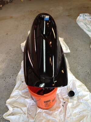

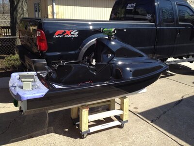

Got the first coat on yesterday, Hoping to do a 2nd tonight. So far the Petti Easypoxy paint was pretty nice. Couple of small air bubbles and one or two runs, but they should come out in the sanding before 2nd coat. So far for $50 in paint and materials I am really impressed, of course we will have to see how it holds up. However, roughly 75% of it will be covered with a wrap. IMG_3807.JPGIMG_3808.JPG IMG_3809.JPG IMG_3810.JPG IMG_3811.JPG IMG_3812.JPG IMG_3813.JPG

The 2nd coat seemed to have a little more bubbling in it. Maybe the weather being a little cooler, IDK. But for $50 and painting in my garage I'm impressed. Plus 75% or so is covered by the wrap.

Sorry thought I posted that, I ended up Roll and Tipping. Which like I said, its not perfect but for $50 I can't complain.
Firsts Pics were taken about 4 hours after paint, with natural light.
Second Pics taken about 20 minutes after, in the garage.
So its very glossy without even a wetsand and buff. However, a wetsand might clean up some of the bubbles.
