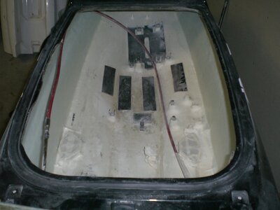

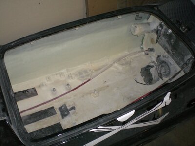

Awesome, I am going to go through and lay in probably 2 layers of 12oz biax along the hood lip. Then probably 2 layers of 12oz biax under the pole area and call it good for this season. Next year Ill lay down a layer of carbon over the sides...maybe. I cover my work bench in cling wrap and wet out all my pieces on that then use a plastic body scraper and force out as much resin as I can before laying it in the hull then use different sized scrapers once in there to pull out any extra resin and all air bubbles.
The last few posts have brought my spirits back up and keep me at ease while on the water this season not worrying about total destruction.

if i had a flatwater ski i would do one thin layer of carbon fill the bondline and hoodseal with the lightest epoxy/filler i can find.
i want to see some pictures.

Here are a couple finished pics of the sides.
