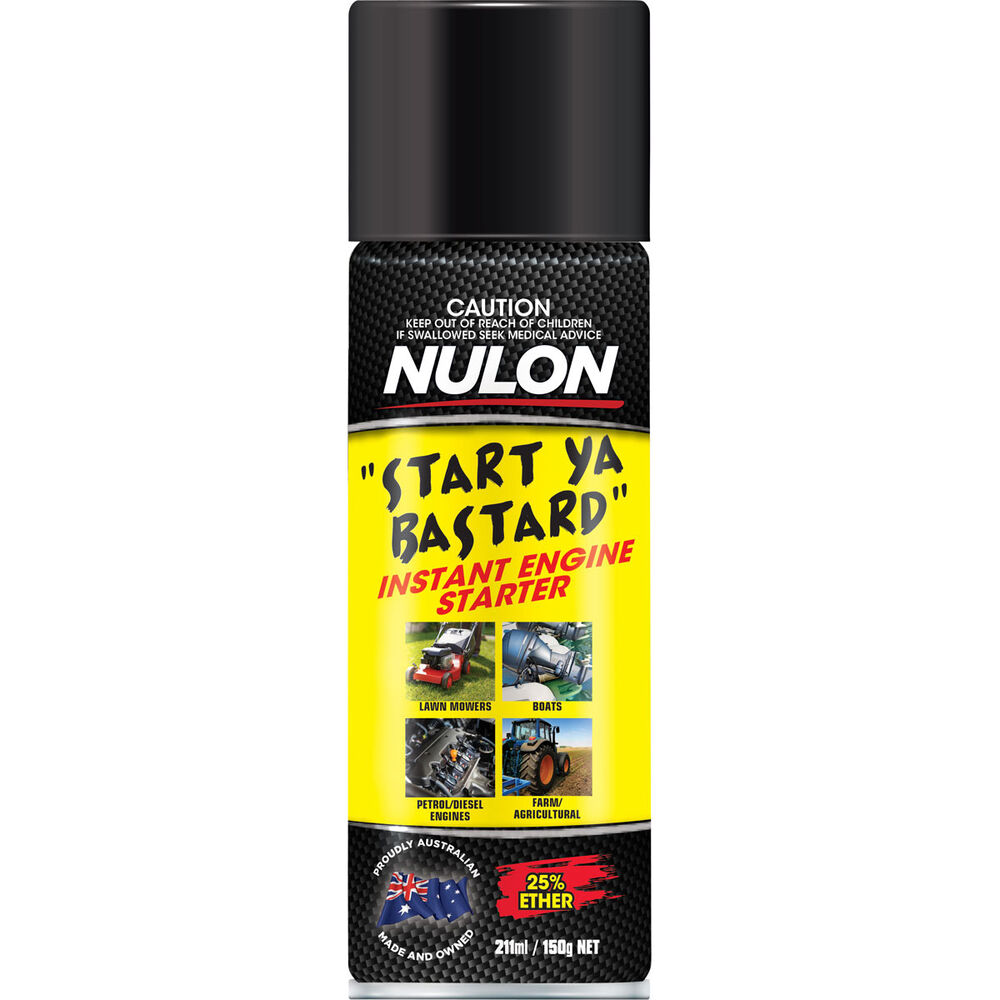

If all else fails keep the ski industry economy going and use:
