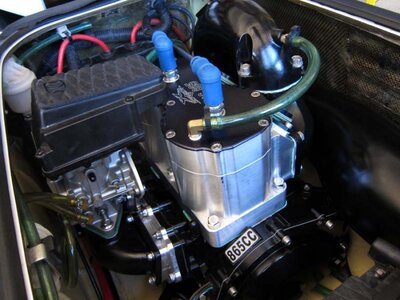

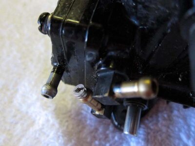

Any educated opinions as to which method of return line restriction is preferable?

Definitely not #1, because you're restricting the incoming fuel, not the return line.
I am not sure what's going on in #2. What is that?

#2 looks like it is threaded into a fitting on a kart tank (?) which will work just fine. Definitely not #1.

Yeah....I realize that restrictor is on the inlet spigot. That's a throwaway carb I was practicing on.
The other picture...it's on the return spigot of the cart tank.

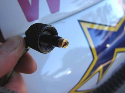

Ace sells a 1/4 to 1/4 barb, buy it and run the jet in the incoming side, splice in return line and done. easy to remove and clean if need be as well.

I've already got the return spigot on the tank tapped and ready to go.
So, I guess my main question is... retriction is restriction, right? It shouldn't matter which end the restictor is on, right?
My OCD has me obsessing that it should be on the carb end, for some reason.

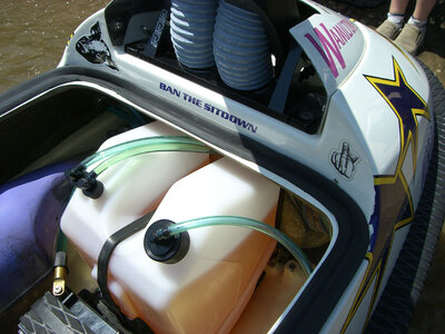

One thing to think about with the restrictor on the tank fitting... If that comes off and goes into the tank, it may take you quite a while to really figure out what went wrong.

I would put it at the carb like #1 except put it on the return nipple.
The 2nd way I would do it like Brian said with a splice connector, keep the hose between the carb and jet short as possible.
The reason I don't like it at the tank as there's too much fuel line between the carb and jet.
When the lines are that long the fuel pressure can pulse and fluctuate with the lines bouncing all around.

That was just a carb he had lying around, it just was testing the installation of the jet. He already posted that he knew it was on the intake not the return outlet.
