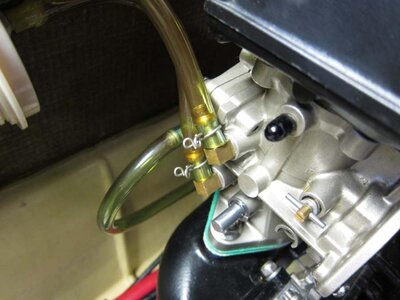

Some more of the reasoning to have it on the carb is there is less fuel and rubber hose between the fuel pump and restrictor, so it pressurizes quicker. Now, that's the theory, whether it actually matters with the small volume we're talking about and the low pressure, I doubt it, but of you wanna go OCD on it might as well put it on the carb.
Aquaholic
World's Oldest Teenager
San Diego, CA.
I would put it at the carb like #1 except put it on the return nipple.
The 2nd way I would do it like Brian said with a splice connector, keep the hose between the carb and jet short as possible.
The reason I don't like it at the tank as there's too much fuel line between the carb and jet.
When the lines are that long the fuel pressure can pulse and fluctuate with the lines bouncing all around.
Done.
Chuckie...thanks again...this thing rips!
