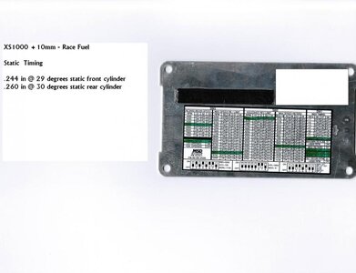

Have a question for you. But first a little info on what I'm running. 62T motor, Sleeved and bored to 84.5 mm, Case and cylinder porting, B Pipe with mod chamber, Xscream 46 mm carbs, Jetting - Mains 115, Pilots 122.5, Pop off 14 psi, MSD Inhancer - 22 degrees max timing.
Going to change to a programmable Ign. For a timing curve I was going to start with 32 degrees at 2000 rpm and start pulling that out at 4800 rpm and be back down to 20 degrees at 7000 rpm.
Just wondered what your thoughts were on this?
