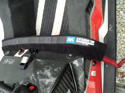

+1 For the Mac fleece like Brownie said. I got mine to eye bolts but you could use it like uwswimmer is with an endless strap and go completely around runners.

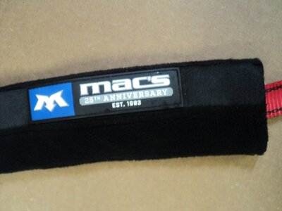

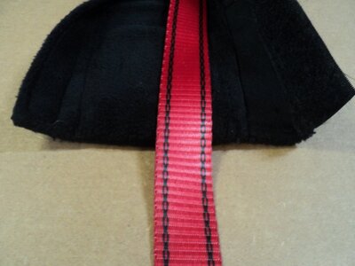

The foam is totally encased in the fleece. Picture a 4" wide sock, with 1" of hook on one side and 1" of loop on the other, with the foam spaced evenly in the sock. The hook and loop fold over your strap to keep it centered. I use a 1" wide strap which centers nicely on the 2" foam. Buy the widest, longest one Mac makes. The excess just adds protection for your prized possession. So far this thing has held up great, no unraveling ,doesn't come loose and does a great job of keeping strap from "wandering " around on ski.
@Brownie @mikesx are the Macs fleese covers foam padded on one side? I noticed they also make a set for 1" wide webbing where the sleeve seems just as wide as the sleeve for the 2" wide webbing that seems like a great option. Just curious about the padding or is thr sleeve thin?
DAG
Charlotte, NC
thanks for the photos. better than what the OEM shows haha. Just to confirm there is foam padding sewed in or is it just fleece? If so i think i'm going to order a set of these. Thanks for sharing
Yeah there is probably a 2" wide x 1/4 or 3/8 thick piece of foam/padding sewn in. I ordered 32" long from Summit racing thru ebay, about $24 shipped.
