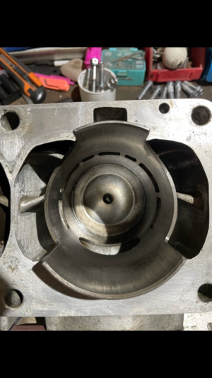

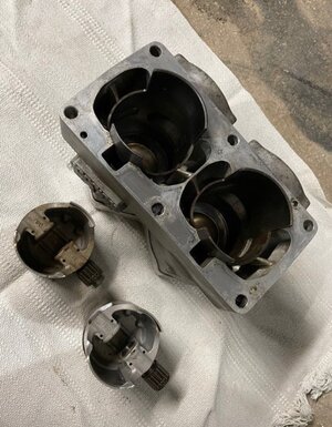

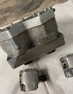

I found a riva racing 7 ports cylinder, is it a good cylinder to do bouys with Superjet ? Reliability?

I'm sure it would be a great cylinder for closed course power wise, however it should definitely be inspected and checked regarding deck height and all of your port timings as it could possibly be a stroker cylinder or require some crazy concoction to work. Such as custom domes, or rod length and even pistons. These things will be very hard to tell without measuring everything. If that is above your ability, then I'd send it to an experienced engine builder and have them look at it and tell you what it needs.
dfw
Thats an old race cylinder. They typically had high ports so your biggest problem will be poor throttle response with pump gas compression. A lot of these were set up for a longer stroke crank so you need to do some measuring.

These were very popular race motors back in the late 90's Pro Mod days
I built a Ton of them! (as shown in my Avatar pic!)
Most all were +8m Long rod x 81.75mm Flat Top pistons
Which made 799.89cc Or fit perfectly into the 800cc rule at the time.
They were avail in both PV & Non-PV versions
Most all were run with the then R&D Dry Pipes, Total Loss, and 220# plus compressions
They were a Handful to ride!
As time went on, they became popular with the freeride / Freestyle crowd, and several strokes, and bore sizes became options
Anyway, Feel free to contact me directly for information on getting this going. Most parts are still available, except maybe sleeves?
Those would probably need to be made to order.
ski ya, Paul
