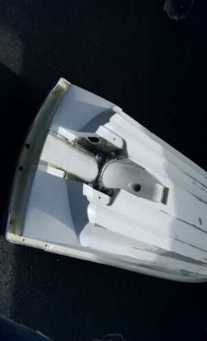

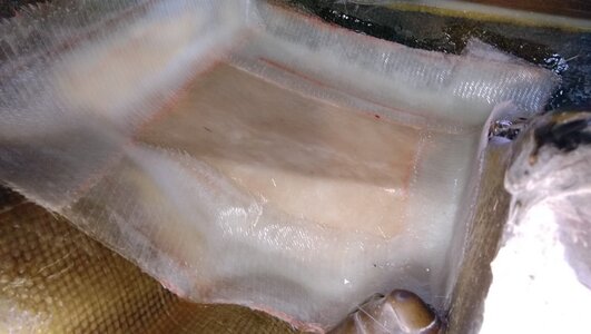

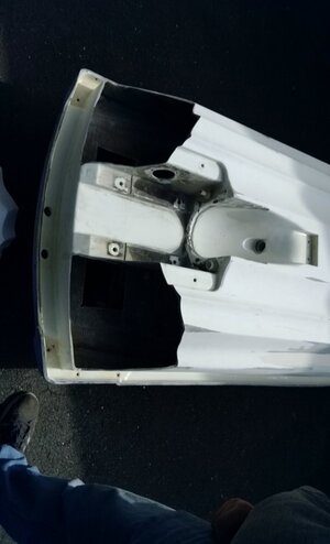

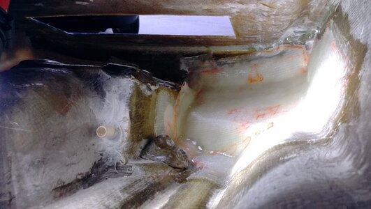

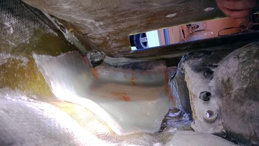

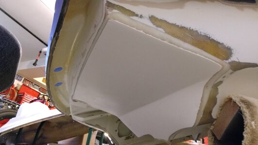

In the process of installing a rocker and chop on my blaster. I've skimmed threw all the blaster threads. When it comes to installing the new panels what do most do over lap them and glass the inside then grind the transition? Or fit them to have a butt joint? From what I'm seeing is most overlap the joints and use screws to hold it in place while the inside is glassed then grind, putty and sand.
Looks good I would overlap onto the original hull on the inside a couple more inches if I were you. The more surface you can grab the better.
player1
Player1
USA
Scallop & glass the outside or it will crack your paint work and eventually fail - Seen a few do that.
