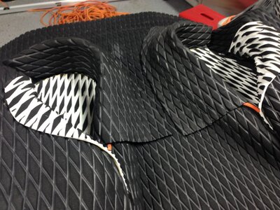

26mm is too much on top and bottom. i tried for 2 to 3 rides last season. way to tight even with super thin wrestling shoes. my shoe size is 10.5 US. i was unable to kick in all the way no matter how hard i kicked.
i left the 26mm on top, and cut out the bottoms inside the foothold area and put 2 layers of 9mm.
worked out perfectly last season.
this year, i am running 26mm on the bottom, and 2 layers of 9mm on the tops of the footholds.

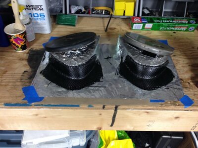

i got in about 3 rides before my heel locks kept ripping off. after gluing multiple times, i finally cut them out, and made custom ones out of carbon and frankensteined back together.
