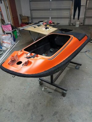

I see you're using what looks like couch mounts.Have you set your engine down in yet to check alignment?
Couch mounts will not work in that hull.
Ok.....The two types of couch mounts that I had would not work in this hull.This is not true......

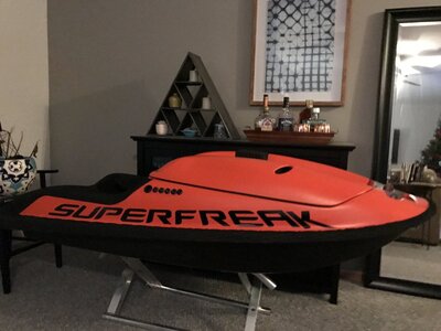

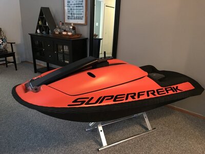

agreed! What RRP pole did you have and is it for sale?View attachment 324047
Both of the superfreaks. Really glad I ditched the RRP for the scream pole, looks way cleaner.
All 4 line up like the one I posted above. Its all the way forward. I can get a tiny bit more when I'm able to compress the pump seal more while not taking a picture but it's still nowhere close.
Is there junk in the midshaft?
