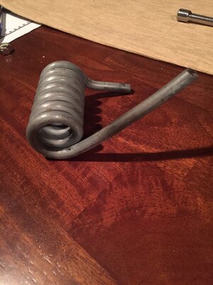

The vise worked like a charm. The spring is definitely a tight coil. Do you guys run a RRP pole without a spring? Should I have spacers in between the pole and the bracket? This just has the molded ones on the bottom piece of the pole.
Stockton
I'am running no spring and a spacer, Blowsion sells an RRP cast poll spacer, I'am sure others do too, the billet poll and cast use a different a Spacer.
I'd like to try both a spacer and a spring though, like the other member did
Have you rode a ski with a tight poll ? takes a little getting used too
My brothers fx-1 had a tight pole and it felt weird to me. My SN has a spring but it never stayed floating on its own. I think I'll try it without a spring and see how I like the feel of it. Then try an oem spring if I need more let off. I'll look into getting a spacer too
I've tried no spring too and just can't get use to it. I find myself adjusting the height of the pole all the time. It's one of those things that's totally user preference.
Here's how the spring looks now. I'm going to try and bend it a little more so it's not as tight and go from there. I might just see how no spring feels too. The last thing I want to do is fight a pole that keeps wanting to come up on its own. Thanks again to @Harbor for all of the help. Really has gone the extra mile in getting me ready for the water. Thanks to everyone else too. This sport is full of mysteries!

I used a heavy duty spring on my build with a BOB bracket and Titan billet pole.
I had to heat and make several bends to make it work right. It's easy to do with a propane torch if you have the vise.
