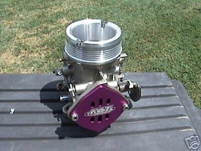

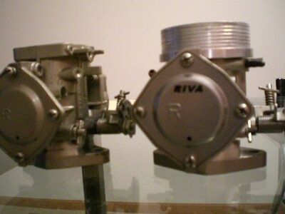

Full Spectrum just drills another hole at the top the same diameter as the bottom hole.
Hot products offers a billet aluminum cover that only uses two allen bolts with few more holes.
