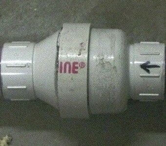

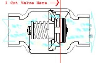

I used this one:
PVC Adjustable Spring Check Valves
77920 1225-20 5 lbs. 2" 9 3/4"
Except I cut the valve in half, changed out the spring to a 1/2 pounder, glued it back together (adding an extra 1/4" of throw) and reinforced the "seam" by using a piece of PVC as a sleeve. I probably won't do that again though, it was a little too much work.

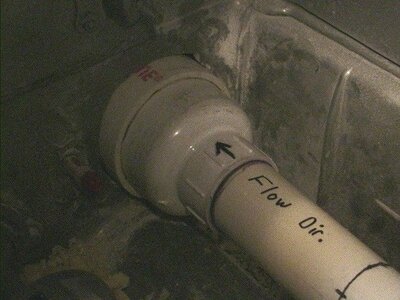

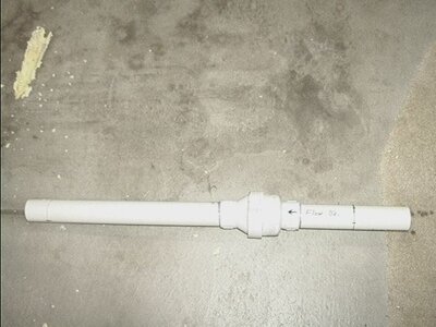

Here's a couple of pics of mine. The valve is about a foot from the firewall, so it's "protected".

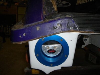

I run a scupper from XFT, 3 inch keeps my ski totally dry and doesn't leak when the ski is floating. A little pricey but you get what you pay for.

If you change the oem 5 lb spring out for a 1/2 lb spring, they work just fine. Otherwise, I don't think there will ever be enough pressure to open the 5 lb one.
