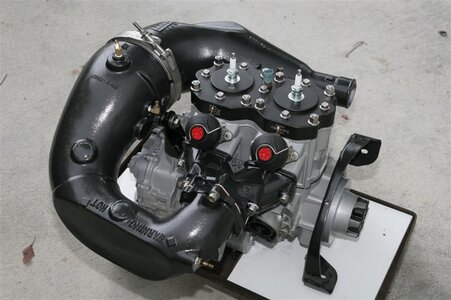

I put my new 951 on the scales....I'm waiting to hear the weight of the 66E :noevil:
I too am dying to hear the weight of these 66E (Yami 800). And I don't mean short block...I'm talking flywheel, stator, rave valves, starter...everything but pipe and carbs.

20 days later and no one posted the Yamaha 800 (66E) motor weight so...
My complete 951 weighs 127LBS with the EXTREMELY heavy oem pipe, starter, motor plate, relatively heavy PTO/coupler and billet head. (look at post #28 for reference). So subtract at least 25-30lbs for a fair comparison.

I took my motor out and weighed it..
It is complete ready to run with (just took it out of the ski all I did was empty excess water out of pipe):
R&D head
VFII's
JSU Spacers
Fly Arrestors w/ adaptors
Wetpipe
and the bedplate
It weighed 92.9 :eek5:
roughly 35lbs difference from the SXR? now we are getting heavy but I've shaved that much weight off my SXR already so we are back to stock weight. I guess the power increase will make up for that.
