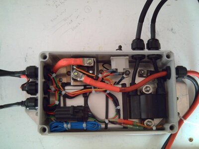

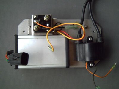

Keith T-I am not criticizing at all-but I don't see the MSD controller in your box-am I missing something? The problem I have found is that the MSD controller is NOT 100% waterproof. It seems to me that if you wanted a part in a moisture proof box it would be the actual MSD controller.
Gil, No probs - its an ATP set up - the brain is ally in colour and is at the bottom left hand side of the pics, held in place by three tiewraps

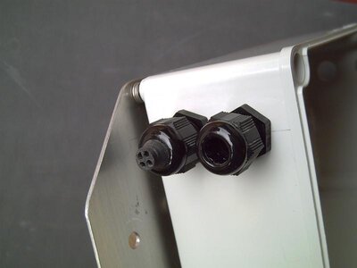

maybe you can get your hands on some of these grommets - I got these off an old kwak elec box, theres loads of them floating about
