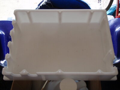

Here is what I've come up with so far. The engine is out of my ski right now so I really don't even know if this will be too big. It's about 1/2" to 1" short of the midshaft coupler so maybe. Still need to figure out how I'm going to attach the lid but I figure a gasket or some sort will be necessary.
Couple things I've learned already... First polycarbonate is extremely hard to with. You can't use any kind of normal glue to hold it together so I drilled and screwed everything together and am putting a more expensive silicone on the edges to help seal out water (and hoping it works). Also this stuff really heats up your drill bits!!

Isn't it like $5 plus shipping for 1.5oz of it though? Not sure that would do a whole box or not. Although I guess in hind sight, I've spent almost that much on the silicone and stainless steel screws and spent probably 10x the time. Crap...My decision making power in the last few weeks has been terrible.
