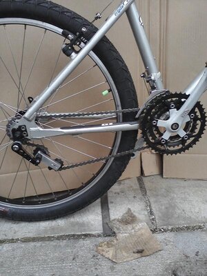

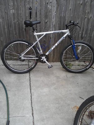

After building up my full susp. bike over the winter, I got the bug for a singlespeed. SO, i picked up a GT Pantera AL as a donor, and built a SS this weekend. The GT had been backed into with a car, and had bent/broken wheels, shifter pod, v-brake arm, forks, handlebars, and seat. A quick trip to my local Performance Bicycle store, and i had everything I needed to build a nice bike.
I mounted WTB Graffiti 2.2 tires on Shimano Deore wheels. Then coupled the GT 3 ring chainwheels to a Forte singlespeed conversion kit with a new chain. Next, I was able to reuse the Bontragger gel seat, Suntour XCM forks, and mechanical disk brakes left over from my full susp. build. New Forte pedals and Oury grips complete the bike.
This is the perfect cruiser for around the house, and a great bike for my wife and friends, too.
