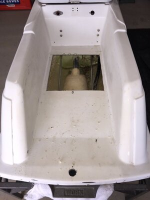

I have my ski on a work stand right now without the gas tank in. I lifted the back end up and down really fast and it wasn't very heavy and I didn't hear any sloshing. Maybe I'm getting lucky. The hole where the exhaust goes through is sealed so any water I'm having wasn't coming from that.
The waterline was fairly easy to remove. Pull the pump out, disconnect your rubber water lines and give it a tap with a rubber mallet to loosen it then pull it out the back. Mine was just held in place with a bit of silicon type sealant at the ends and the foam is probably holding onto it inside as well but once it budged it was easy to pull out. The ski was a surf/saltwater ski before I bought it. And it's a 97 model so it's seen a lot of saltwater over a 17 year period.

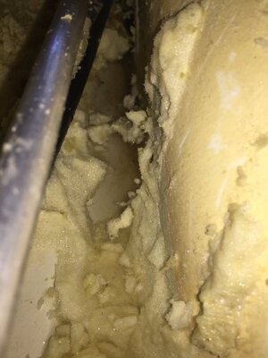

There are 2 holes through the engine bay rear firewall about an inch in diameter thatimage.jpg had some sealing tape over them, when I peeled it off and jammed my finger through into the foam I could tell it was wet. I couldn't hear any sloshing but once I dug out the foam the bottom had a horrible foam crumb soup left in there. It was wet right through to the very tail.
Your midshaft is probably not sealed to the firewall well so that the water comes in from behind from the water pressure of the pump, where the driveshaft enters to the midshaft in the pump tunnel.
That area is before the inlet to the pump so there shouldn't be any pressure there. If anything your pump would be sucking air out of your engine bay through the mid shaft assembly and causing cavitation if it isn't sealed up properly. Of course it might still let water in when the ski is sitting in the water.
He needs to run the ski on the tralor in the water with the hood off to look for the issue. Pull coupler cover off and check everything. Maybe it's just a bad hood seal. A surf strap will help with that.
