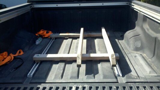

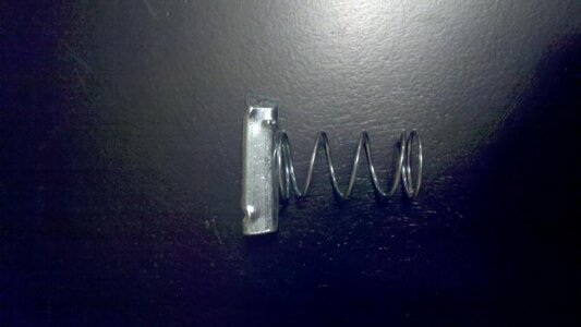

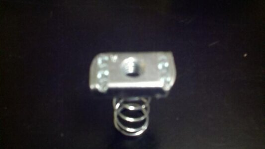

I put a makeshift rack made out of scrap 2x4's in the bed of my titan and anchored it with the utilitrack. I used conduit anchors (I believe are called ETG strapping) which fit perfectly in nissan's utilitrack. I can snap some pics of it tomorrow when it's light out if you'd like, although your design will probably differ a lot from mine with the lift and since mine was thrown together in 10 minutes. I'll attach the pics of those anchors though, they're pretty useful. They can be picked up at the home depot for less that $5 a bag.

Here's the pic of my rack in my titan. I originally had it centered between the two utilitrack channels but offset it so I can fit a beach cart next to the ski so I can load and unload by myself.

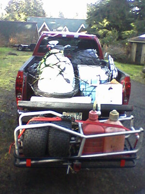

Something to keep in mind when backing any vehicle in to launch. Be very aware of the locations of axle, transmission vents. If you back in so the water level is above your vents..... Guess what. You now have water in your differential and possibly in your trans too. Some diffs use vent caps on the top of the diff and you are very limited as to how far you back in. Transmissions are the same. I removed the caps and ran lines with loops all the way up to the master brake cyl. Hard (and expensive) lesson learned some time ago.

dont forget beer...

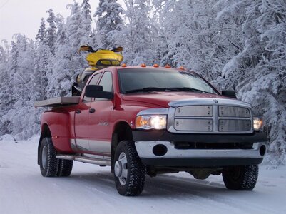

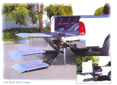

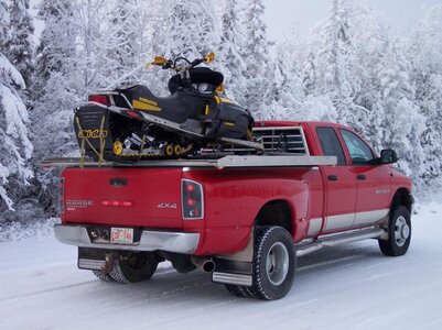

I see. That would be pretty slick. Hope you plan to support it from beneath with something. I know if I tighten my ratchet straps tight enough using the clamps on the utilitrack on the sides of the bed they flex quite a bit. I'd imagine a rack with a 300+ lb. ski on it may do the same. A riding buddy of mine has a hydraulic platform like the ones you see people haul their snowmachines with above the bed of his F350 thats pretty slick. He welded up a new platform out of 2" square aluminum and put razor scooter wheels on it to hold 3 ski's. He can just pull a pin and switch between the ski platform and snowmobile platform. It's powered off a spare battery mounted in the bed and just slides off the back of the truck and lays flat on the ground. Off topic, but I guess it's an idea to make a rack that sits on top of the sides of the bed and uses the utilitrack to anchor it all the way around.

That is pretty damn slick. I didn't find it at Harbor Freight online but it is available on Amazon for $369.97 it's a Larin TGL 500 Hitch Lift.
If it could be adjusted to pick from cart height up to a set of bunks in the bed it would be pretty sweet but still slow and prone to failure and maintenance.
I still bet a set of sliding and tilting ramps would be easier.?.?
Another cool shop cart along these lines is the CHASSI LHAT10 lift/hitch/AT10 Combo cart. Great for loading onto the truck at home but doesn't help you at the beach. It would also need a drill setup on the winch because hand cranking would get old real fast.
