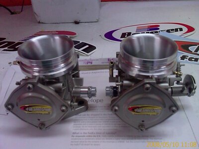

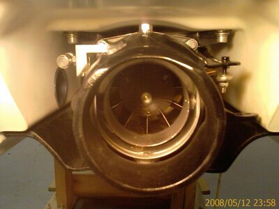

What size is your pump nozzle? I read where you said the steer nozzle was 84 mm.
Also what kind of pump shoe is that? I am getting ready to put a 750/800 pump into my X2.
Thanks,
DAVE
The reduction nozzle is bored to 84mm. The pump shoe I ordered was from Sue at Jetski Unlimited, its the only alluminum pump shoe they carry for 800 SXR's. From looking at EME pics, is looks very similar.
Hope that helps

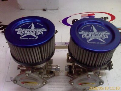

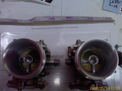

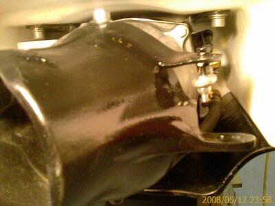

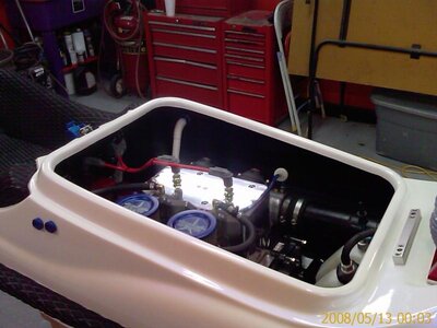

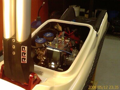

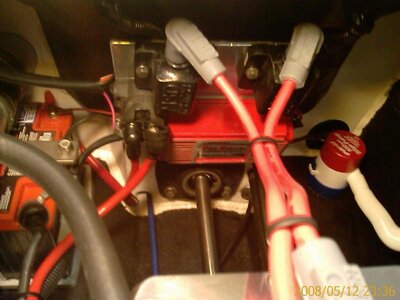

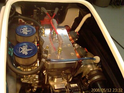

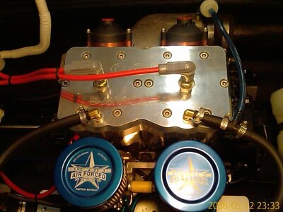

The engine compartment is done!!!! Here are some pictures, plus some other things. The steering quick turn work real well, so I had it welded today, then I painted it.
pics

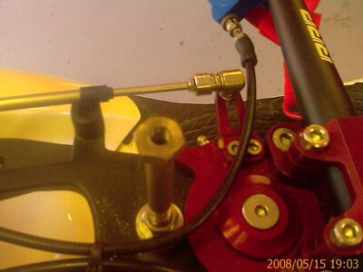

more pictures

kinda curious as the reason behind that oneway going to the pipe? if their really that much water in their its going to backflush

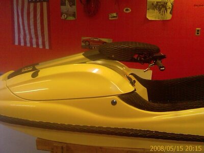

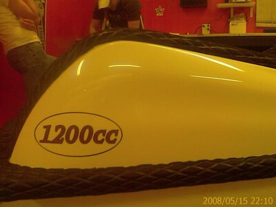

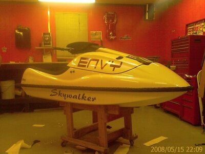

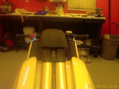

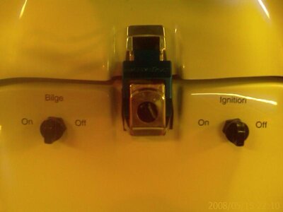

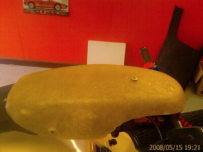

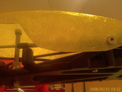

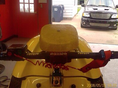

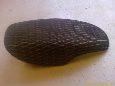

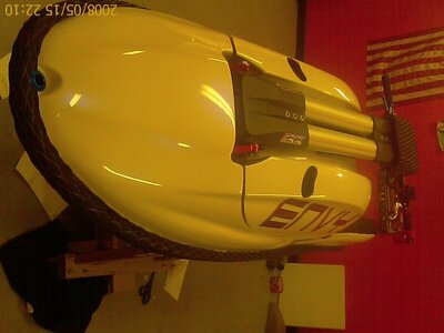

new pics of chinpad install and new stickers. Im not so sure about the ENVY sticker, might have to change it, give me your honest oppinion.
more
