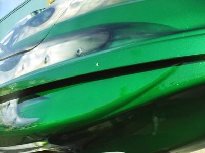

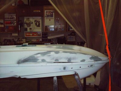

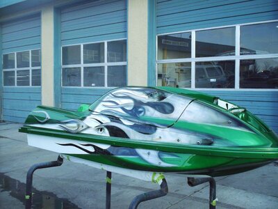

I won some hockey tickets from work so I took my son to the game. I might have to wait until sat. to finish the install. They're a bit of a pain to install solo. I'm a little worried about the epoxy setting before final placement. I've tossed the epoxy resin in the fridge to slow down the curing. I hope to install and flair in before my sunday ride.
family first... :smile:
here are a couple pics, you can see better in the close up.
i used DURA GLASS to build up
i attatched with 3M pannel bond and screws into aluminum.
that paint is so nice... I remember when you had this done, or you did it.. can't remmeber

hey slut, did you leave the screws in and fill over them or did you take them out after the epoxy hardened?
I left them in.... No need to remove them IMO
After the epoxy drys, just fill over them w/ evercoat filer
I think they add structure...
to get rid of the screws sticking through, just clamp down on them w/ vise grip and bend back and forth till they bust off, or us a chisel and a hammer to chop em off flush.
