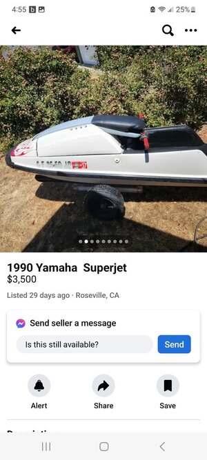

A decent 701 61x stock square is worth 2k USD. 62t w/ b pipe bumps price to 3500 or so but getting more than 4k is tough on the old ones.
Depends where your at. Your not finding any superjet for 2k in california. Oregon. Washington. Nevada or Arizona.
That's why I said. What's 1200 bucks. Apparently it's something elsewhere. I remember buying a full breakfast for 4.50 in Ohio. And tipping 10 bucks and absolutely blowing their minds

Yeh idk about that. Alot of these skis are redone. Hard to find a stock unmolested ski. Trust me. I'm constantly on market place. I'm very familiar with the market. I make a good portion of my income buying, fixing, and selling.
Get on actual marketplace and look at the actual market. Not an opinion of value that is outdated. Value changed a ton in the last 3 years. 1200 bucks is nothing. Especially when it comes to time.

If youre willing to spend that you might as well find a round nose from the south and ship it north. 3500 is stock RN territory, 3500 for a square it should be 100% fully loaded. Don't fall for west coast scam pricing.
