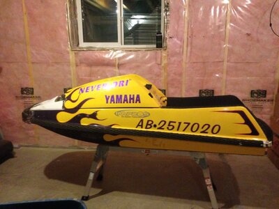

How long have you had the hull? I swear I saw that same one complete at the crane lake races in August.

image.jpeg This was probably the ski Ian was on but with my hood. I was not at crane, I only wished I was haha. I don't currently own a running ski actually.
