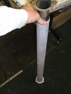

the RN box and RN exhaust tube are a bit larger in diameter. the RN tube is a pound or two lighter than the SN tube as well.
the SN tube was designed for a 650 motor.

I cut mine in half at the seam and removed the baffle box. Then I used plates, rivets, and epoxy to join the halves back together. Gave it a meaner sound not as loud as some aftermarket boxes. Go for it, Its an easy project and its no louder than a Harley with straight pipes.
