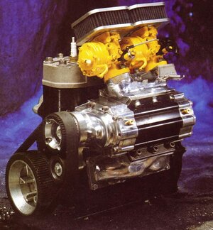

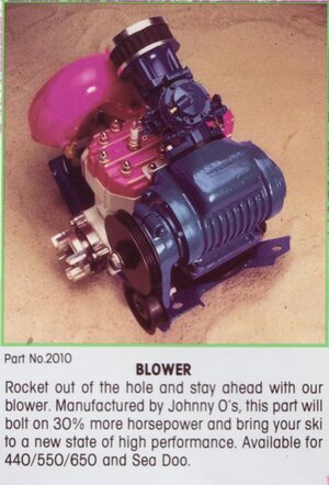

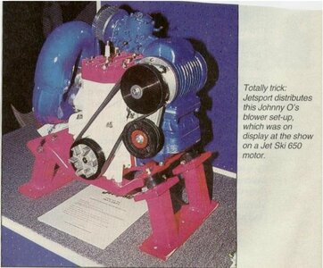

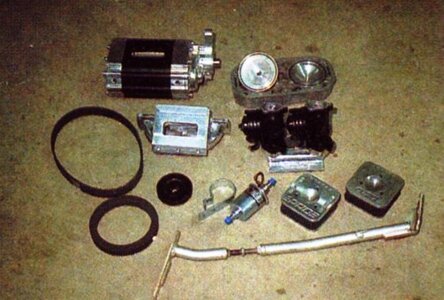

so who is gonna run this on their ski?
Here are some ads for them... And Fischetti's Holeshot race type.
