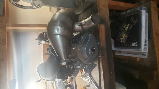

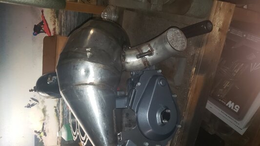

This is the c4 chamber I had. Noticable difference in the cone at the very end. The OP chamber is definitely a later tnt chamber with the 12 sections.

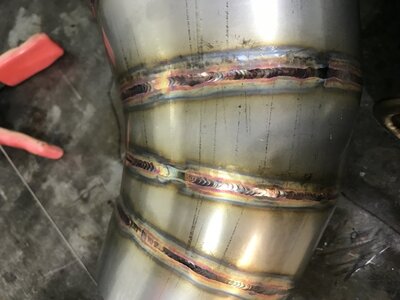

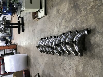

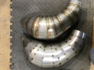

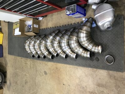

Sorry guys, that is in fact a clone. There a guy in Clearlake or Willows ca who has made quite a few clones. His patterns are hand cut so the weld seams are not clean and pipes very in size. I cant see how thick the material is but it’s pretty close to SS chamber. motor should run pretty similar to real Tnt, i just don’t know how thick the material is so can’t tell you if it will hold up or not. I also don’t weld the bracket in that place or the outlet like that 6276CB58-EC30-464A-99AA-CA3163B1DA86.jpegD95DB610-9BD4-42D4-8956-4B0FE186C33B.jpeg2B469389-3401-4981-8202-AA306EB3ED42.jpeg5994DB44-1B9D-4FD0-8EEB-5E62AD9D1936.jpeg
