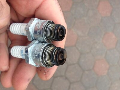

Spark plugs lasting 6 hrs

if your plugs look like those black slimy things in your post, you are probably about 2 mains high.
if they are grey, you are 2-3 mains low.
IF they are the color of a Filipino, or a properly TOASTED marshmellow, its good to go.

turn all screws on the b pipe in all the way except 1/2 turn out on the bottom. this is a baseline.
either get a $12 USB 5mm wide camera on ebay to make sure piston wash is there or pull the head.
pistons should have black built up on them everywhere except thumbnail sized shiny spots by each of the 4 transfers and 1 by the boost port. if the piston is super shiny and clean, it is either: really friggin rich, or leaking a small amount of water in, amounting to a steam clean effect of the piston.
pull the intake manifold and check the reeds for chips or other shiz that doesnt look right like lifting off the cage, cracked reeds, chipped reeds, cracked/missing rubber from the cages etc.
apply a light coating of grease on gaskets when reinstalling manifold and carb base gaskets and such.
