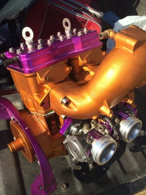

I've had good look luck with VHT paints. The purple piece by the PTO is anodized purple paint. It matches the anodizing on the head, carbs, and intake well IMO. The burnt copper is also VHT and I was less than patient with it and it still turned out OK. The engine was sandblasted before painting.engine.jpg
